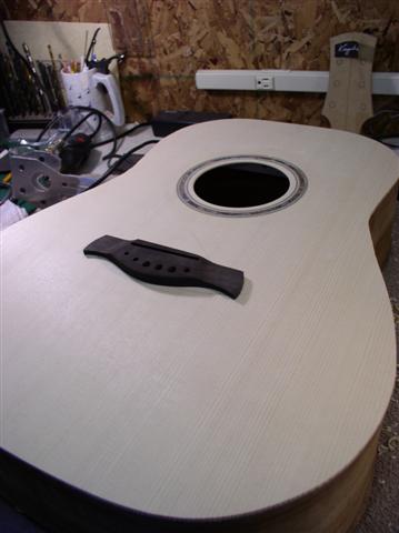

Just sharing a little of what I did this weekend.
I managed to get the Carpathian Acacia Dread closed up. Hoping to get the purfs and bindings down this week, Then I get to move on two the neck, in which I'm pretty excited as I get to inlay a Waymann vine down the fretboard. Should be fun!
Thanks for looking -
btw this will be a 12 fretter/slot head with gold Waverly's, snake wood buttons.

PostPosted: Sun Aug 28, 2005 10:01 pm
Thanks Guys!
[QUOTE=Kelby] Really nice, Lance. I'd love to see the rosette a little closer.[/QUOTE]
Kelby, here is the rosette, its Red abalone heart bordered by b/w/b(flamed maple)b/w/b also pictured are the b/w/b(FM)b/w/b purflings that will adorn the top along with snakewood bindings.
BobC custom made these purflings for me, and used some seriously tasty Zoot for the flamed maple centers!

PostPosted: Mon Aug 29, 2005 3:08 am
Those arrows are my paranoia showing! I candle the tops and trace the bridge patch and X brace on the top, then lay it all out, making sure the bridge pin holes fall in the correct location in relation to the patch and braces. Measure twice cut
